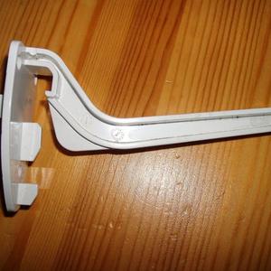

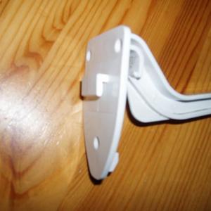

    I think I'm nearly at the end of this saga. Quantal responded via telephone, I think their contact page on the website is broken. I showed them the pictures and they confirmed they were Quantal brackets of a current design, and gave me the details of a local supplier. Turns out that supplier...

    Apparently, according to the folks at Truly Conservatory Repairs, the brackets are made by Quantal, and are obsolete/no longer manufactured. Quantal are not responding to my inquiries. What next? Whole new roof?

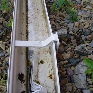

    Does the group think this looks likely: OG/K/2/* Top Hung Fascia Bracket White, Black, Brown and Caramel 100 From here: http://www.plaslyne.co.uk/pages/kayflow_ogee.htm

    I did a better picture of the bracket, and one not so better picture of the back. They have no identifying mark. I'd contact the conservatory supplier but they no longer exist :(

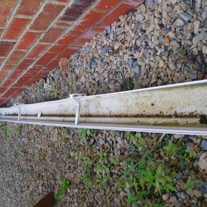

    Hello friendly folks Summer's here and it's time to repair the conservatory guttering that the snow ripped down earlier in the year. I still have the guttering channel, but several clips are broken, also some clips are broken on one of the channels that's still up. I haven't been able...
