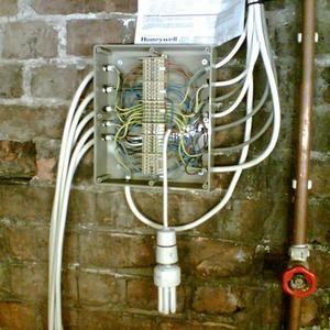

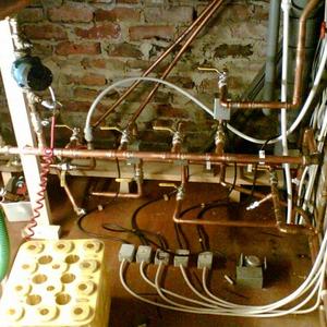

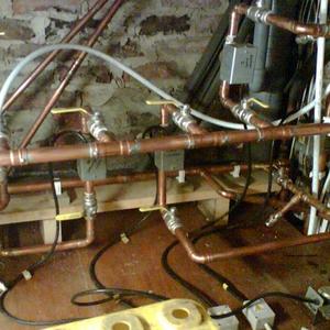

  13. H
    Alternative to TRVs?
    Ok so I'm after advice on the mother of all central heating systems. Rather than fiddling with TRVs and adjusting them weekly (daily even) as ambient temps raise and fall, I want to automate the system as much as possible. Currently got an old Combi providing the 'umph', but the rest of...
