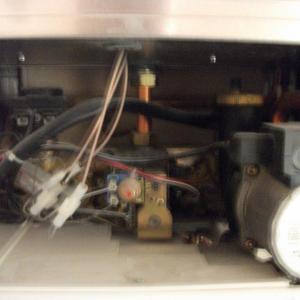

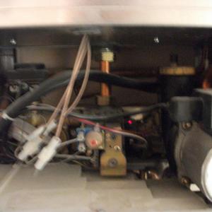

    Thank you for the information... I have tried to ignite but can't see the flash through the window. We took the front panel off and noticed that there's a red light which comes on when trying to fire it up. There's an image of this on my profile photo's Thanks again for your information...
