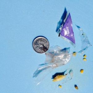

    Hotpoint Aquarius FDW60 - not cleaning and alot white powder
    I found your website whilst trying to find out why my Hotpoint FDW60G was not producing clean dishes, and the information here helped enormously. Following instructions, I removed both spray arms, and was astonished to find so much debris inside. If I had not done it myself, I would not have...
  2. Dishwasher Spray Arm debris
    Removed from upper and lower arms after reading about this being a cause of poor washing results on this website! (5p shown only for size comparison)
  3. Dishwasher ARM
    Dishwasher ARM
    Debris removed from the dishwasher arm water outlet jets (excluding the 5p piece, which is shown only for size comparison!)
