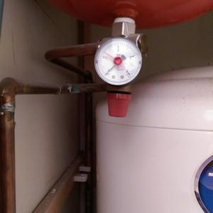

    Hot water running low
    Hello guys and thank you all for your help and inputs. Last couple of days I had a bit more time and do some more tests and find out what the real problem is. It seems like that i made an early judgement saying the cold water pressure was good. After identifying that the main cold water run...
  2. H
    Maybe my main question should be, is hot water systems pressurized or solely relies on main cold water pressure to push water out of tank.
  3. H
    Hi and tanks for your reply I have checked the main stop cock and its fully open no problem with the cold water pressure anywhere in the house the showers are just mixing taps (Thermostatic Shower Valve ) hot water's pressure is not that good even at the sink and wash basin taps So...
  4. H
    Hi, We have just moved to our new house and we have a slight issue with showers. The hot water runs very low on both showers, one at same floor of the hot water cylinder and one floor above it. This is a Tribune HE Unvented Cylinder, connected to the boiler on first floor. As you can see...
