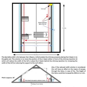

    Hi, thanks for your response, I will definitely get a SE involved for the steels! and the steels would have to go in in sections. See here to get the idea http://www.diynot.com/forums/viewtopic.php?t=137740&start=15 The new floor would be on I-Joist (240mm) suspended below the U Beams. The...

    Hi, I wonder if anybody with experience of Loft Conversions could assist me with their thoughts on the following. Clearly, I’m considering a loft conversion. I’ve been considering it for years, every time I go up there to get something, it really annoys me the amount of space there is, hell I...
