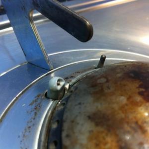

    Ok so its been a while since this issue has bugged me enough to look into it again but that I have. I picked up a burner key from the espares or someone like that, removed the pan stands and using the key removed the part of the gas spreader that is mounted above the base of the unit...

    All the holes in the gas spreader ring are clean and clear. The flame is strong, blue and touches the thermocouple when on. As per the photo i admit the caps are dirty but then they have been a nightmare to keep clean from the start. Going back to my original post, as the burner takes 3-4...

    I'd have to do some testing but I've no reason to believe it isn't. The pan is placed on the pan stand which does some few millimetres above the thermocouple, can't see why the flame would be disturbed by this. I will look into it tomorrow and see.

    No there is a definite click from the control knob then it all goes off. From what I understand this is the safely cut off but I have no idea why this would happen only when pan is placed on the ring. If i dont put a pan on it will burn away quite happy.

    Hi, Been a lurker here for a while and found some good solutions...after a quick search I couldnt find anything covering my current problem. I have a 5 ring gas hob (Smeg P75 72cm)... the problem is a number of the rings light eventually (after 3 or 4 goes) and keep burning. However as...
