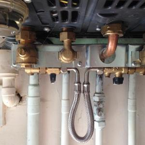

    Weepy boiler valve
    Sweet! Cheers for the link. Quick edit :) You say washers, are these the chaps? http://allaristonspares.co.uk/ariston-gasket-38-1pc-573521-microgenus-ii-2428--31-11473-p Ta! Woops, as you are. Checked the repair manual and yes they are.
  12. I
    Weepy boiler valve
    Morning all, My Ariston boiler has developed an interesting fault. When I turn both taps on to recharge the system (after draining to remove a radiator), the left-hand one leaks. It's only a drip, and it stops when I close the taps, but I don't like it. I've tightened the screw inside...
