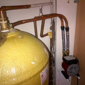

    Bloody hell Daniel that's amazing how you can tell that from the photo. In very basic terms (I am no plumber as you can tell) can you explain what is wrong with this instal mate so I can relay to the fella who fitted the pump. Will I (or the plumber) need to buy an alternative pump or can we do...

    Many thanks both. I've never uploaded a photo on this forum but here goes. Does anything stand out as being wrong with this instal?

    Our current Triton Tesla thermostatic bar mixer does seem to be constricting the flow a few seconds after turning it on or when say adjusting the temp to a higher setting, proper power shower for a few seconds then settles back to not so powerful. Having done a bit of research it looks like...

    Good point the hot water supply now has far more pressure than the cold. What problems will this cause with the mixer shower mate?

    Many thanks for responding mate. By twin pump do you mean both hot and cold or twin impeller? Where are the filters located mate?

    Hi there I'm new to this forum (I usually frequent Audi forums usually to my despair) anyway onto my plumbing issues. We have a gravity fed Triton Tesla thermostatic bar mixer shower fed from a cold tank really high up (very tall old Victorian house) and from a large immersion at about the...
