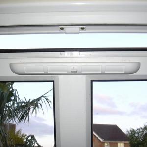

  7. J
    Can anybody identify these trickle vents
    Hi Bit of a long shot, but there seems to be a huge amount of knowledgable people on this forum. I am having a new window manufactured, to match existing windows which are about 4 years old. However the manufacturer no longer uses the same trickle vents. Do any of you guys recognize my...
