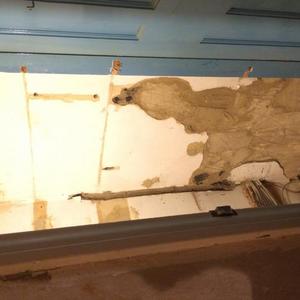

    New to plastering, first job under stairs. Advice needed
    Hi all. Just about to do my first plastering job in the under stairs cupboard, just after a bit of advice. Took a loose bit of plaster off and ended up removing half the wall but the too half seems solid. There were some big holes which I have filled with building sand and cement. I'm...

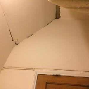

    Wall plate movement
    Thanks for the reply ree. Sorry, bit of a rushed thread on phone at work. Outside is rendered but no cracks. Where I've pulled away the plaster I can see that the brickwork hasn't moved, the wall plate has moved outwards by about 15-20mm. The side of the room in question is sloped and the...

    Hi all. I've recently moved into a 1930's semi detached home which is in need of restoration. I am just after some advice in a particular problem I have. I noticed a fairly large crack, of about 5mm which has been filled several times in the past, it runs through the back bedroom and into the...
