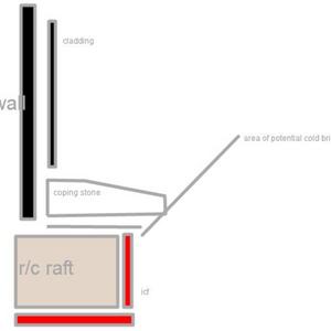

    Any ideas for insulation
    Hi Blagard, the raft is sitting on Jablite with the the ICF and it forming a complete insulated shell to the underside and sides of the raft. lining this shell is the dpm. The r/c raft was poured in one monolithic pour, the surface of which has been polished as the final floor. The jablite and...
  4. J
    Hey Blagard, I think you got the jist even if my term are a bit wayward. I have done a very rudimentary picture of the area, see attached ( I think) Cheers J
    Hi Chaps, I need to add some insulation under coping stones around the perimeter of a building. The building is on a raft that has ICF around/underneath it. There are two different areas of cladding, one being brick, the other shiplap board. Where the shiplap cladding goes, there is...
