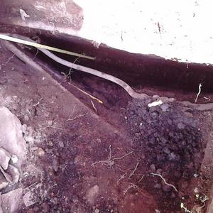

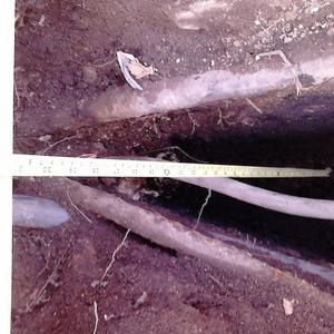

    Here's some pictures of where I've got to. The trench is almost at the required depth. You can see the electricity and gas pipes on the left, and what I think is an old disused gas pipe on the right (although for some reason the uploaded images have been rotated 90˚ anti-clockwise)...

    Trench dug to about 75cm
