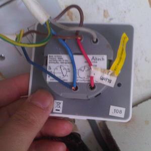

    Worcester Greenstar 30CDi - No heating..arggghhhhh
    The house is warm, we put Marcus in the bath (16 months) and wrapped him in a nice warm towel, and the misses went an bought me a nice beer to go with my dinner. Thank you all very much for your help!!!
  2. J
    Fantastic, Thanks D_Hailsham and Boilerdoktor. Now, I presume if I have CH, the fault lies with the wireles thermostat switch? At least we can be warm if it get's cold again!
  3. J
    Hi Boilerdoktor, The component does not have LS or LR labeled and although I think I'm right in what I'm doing, I'm not 100% and don't want to overload and blow the boiler. Sorry that the image is out of focus. I presume, and I hope that I'm right, that by connecting the bottom of...
  4. J
    Thanks boilerdoktor, Can you just confirm, do I link the wires LS and LR together or link the terminals that they were in? I presume the latter but just need confirmation. If this resolves the issue, I take it that the receiver is at fault? Jason
  5. J
    The user manual states 'CH boost button'
  6. J
    Thanks D_Hailsham The boiler is a WB Greenstar 30CDi Combi Wireless stat is an Altech ALTHC014(TX) Cheers, Jason.
  7. J
    Chris, There is a CH boost button (man with a hat holding a ladder) on the boiler itself. If that is engaged, I get heating. I know the link works on the receiver as when the animated flame starts on the tranmitter the a green light appears and you can hear the receiver switch. I am...
  8. J
    Thanks boilerdoktor, When you mean the "base" unit, I take it you mean the whole control panel for the boiler. This boiler has a seperate wireless controller that has another, what I think is a wireless receiver unit inline between the main power switch and the the boiler itself.
  9. J
    Hi everyone, Go probably a stupid question and can't work this out. - Boiler has correct pressure of 1.5 bar - All rads are bled fully - Hot water works fine - If I press the 'boost' button, it starts to heat the rads - I have the wireless thermostat and when I press to get a higher...
