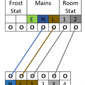

    Thanks Stem, I can now confirm your 4-core cable option works, the below diagram shows in simpler non-tech terms:
  2. Ideal Independent C24 And Drayton Wiser Wiring - Working

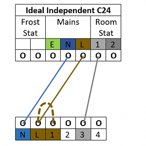

  3. Ideal Independent C24 And Drayton Wiser Wiring 2

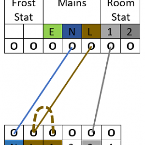

    I apologise if this has already been answered, but spent a few hours browsing and cannot find a clear answer. I am trying to connect a Drayton Wiser One Channel Thermostat Kit to an Ideal Independent C24 Combi Boiler. I have drawn up this diagram, please can you advise if this is correct...
  5. Ideal Independent C24 And Drayton Wiser Wiring
