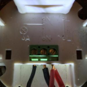

@EFLImpudence that brought it home. It's working now thank you.

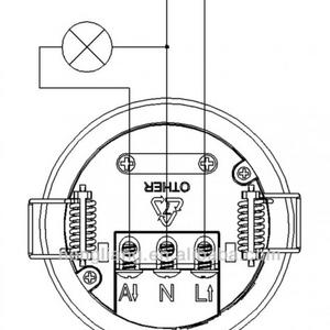

To me it looked like the Black was supposed to go on the A not the Live one.
Thank you for your help!

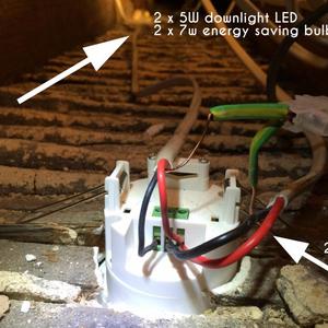

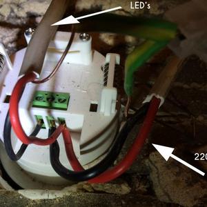

I've set up a sensor to control the light in my bathroom but can't get it to work.
The sensor is ceiling mounted and is a ES-P17 PIR sensor.
I have measured 220v is going in and can hear the click of the sensor when there's movement underneath it, but no light actually comes on...
