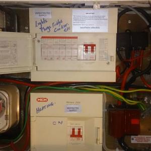

    Hi thanks for reply, yes all dead apart from kitchen. The weird thing is it was overnight so almost nothing would have been on. I just don't understand what could have caused it. Other than the fuse is there any other components that could be faulty, anything in sockets I could check? Sorry...
  4. J
    help please no power in sockets
    Thanks for reply images hopefully attached

  8. J
    Hi would really appreciate some advice, this morning I woke up and no sockets were working, except for in the kitchen Wich are on a Seperate fuse. I assumed the fuse was the problem so I tested by by swapping the cooker fuse with the socket one as they both 30a and same result, cooker working...
