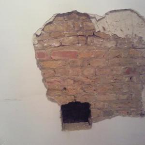

    Fireplace woes
    here is a photo of the said chimney brest.

    Hello all Im in a bit of a spot. Im trying to reinstate a victorian fire place... in a victorian flat. Ive read up on what to do and how to do it, but Im very much stumped. In the 60s the fireplace was removed and a gas fire put in leaving a 3 brick hole to vent it(at this point the...
