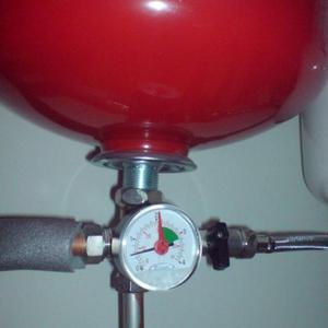

    Glow Worm 18hxi F1 fault
    Yeah, I opened the valves, the pressure increased to 1.1 Bar and have closed the valves again as the pressure did not go about 1.1. As for the ignition fault, I have read that it might be because of low pressure. The boiler has not gone off today, so this may have resolved the problem.
    Thanks for that, there are two 1/4 turn valves on this hose. Have turned them both slowly to open and the pressure has gone up, but only to 1.1. I've put the heating on and turned it up but it isn't going up. Is 1.1 bar satisfactory?
    Hi, I've just moved into a new house with a Glow worm 18hxi boiler. I keep getting an F1 fault and it turns itself off. I have little info on the boiler and the estate agent (its a rented property) says I need to check the pressure of the system before they will send someone out to help, and...
