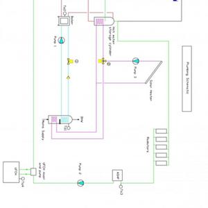

    wood burner and unvented cylinder
    Many thanks for all the responses received, I've made a few changes accordingly. [Norcon: The connection between the stove and uv cylinder is a no no] OK, I can provide a separate pumped circuit from the heat store. This will mean the WBS will dissipate heat only by convection, will this...
    sorry I'm having difficulty loading the picture. hope this is now OK and clearer [/img]
    Hi, sorry I'm new to the site and only seen the topics today. This one very interesting as I am planning something similar and would appreciate any advice or comments. I've no mains gas and fuel oil is expensive, hence want to rely on renewables (and a heat pump) Central heating has a 213L...
