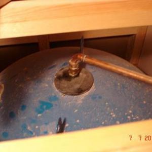

    Here is the photo Steve, I have put my email into your profile. It would be great to receive this - it would be god to get the install of the new coldstream right. Juup

    Hi Steve, This is very interesting info. What we can perhaps establish, then, given it has worked fine over a three year period at ours, is that an Altecnic (its an Ultra Pro 300) will dispense the water out of the top end - even when it is not intended to be done that way :) Here's a...
