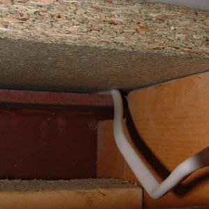

    Sorry for the delay in coming back. Thank you to every one who has suggested a solutions. Found the fault. My house is built with a steel H beam in the ceiling and the lazy electrician who should have drill through it to pass a light cable laid the cable over it. The cable over the years has...

    I am 2 feet short of cable to do a byepass test. Here are some photos to be going along with for now. The red wire that is disconnected in the switch box is the one that if connected trips the mcb.

    OK, the fault appears to be the live feed from lounge wall switch to the lounge light ceiling rose. If I leave this disconnected at the switch all lights to this point work without tripping the mcb. If I connect it and disconnect it at the rose it trips the mcb. What is the easiest and right way...
