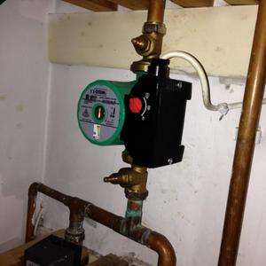

    Hi, I'm helping a mate out, trying to fix a problem with his vented heating system. He had to drain the system last week to replace some downstairs rads, since refilling there's a bubbling noise around the pump and downstairs by the boiler you can hear air in the system. The boiler runs and...
  6. Pump
    Pump
    Pump (under the F&E cold feed and vent), 2-port valves underneath.
