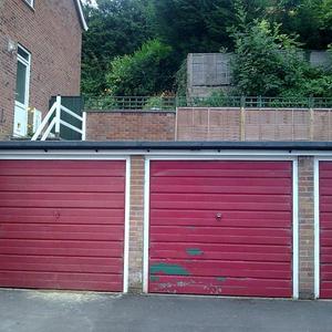

    New felt flat roof mould inside and dripping wet!
    Here are some pics when it was finished back in summer, there has never been any ventilation even when built new years ago.
    Hi all, Would really appreciate some advice here from the pro's, myself and some neighbours had our garage block re-roofed back this summer, they were felted before but had not been maintained for over 15 years, all the joists and decking boards had completely rotted and fallen through. We had...
