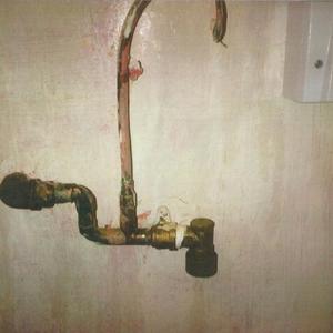

    Can gas pipe develop crack on its own?
    And forgive me if I'm being ignorant, but is it standard/safe practice to leave a detected gas leak, that is so strong a neighbour reported smell it, leaking over night?
    Thank you guys, So it definitely does look like we were not responsible for the leak. We definitely want to pursue this :) Though we have to admit to still having a sketchy grasp of the technical points you've raised (though we're trying!) - bent and soldered copper piping NOT in the...
    OK - have uploaded the videos of the pressure loss and detecting the leak to Youtube (links below) and scanned and uploaded to DIYnot the better quality photos we asked for. Hope they are helpful... Any thoughts guys? http://youtu.be/t7oWt9_wh7g Video of pressure loss...
    I have uploaded scans of the reply letter, photos of the pipe and fitting and Gas Safe engineer's invoice that we received from the HA today. The HA has offered to waive the £187.50 if we stop asking for our £100 incentive. I'm inclined to keep arguing, but am open to suggestions. We've...
