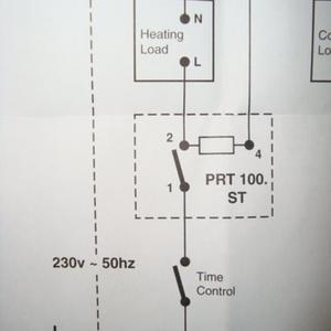

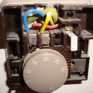

    On the existing unit which is a potterton PRT100 also - I am only replacing as it looks dated and discoloured!!! Red is going to 1 (TL) Yellow is going to 2 (H) Blue is going to 4 (N) There is not a 5 mentioned on the existing thermo diagram!!! So if I understand on the new one this...

    Sorry misread the last post. The inside of the existing thermostat does have a diagram which says: 4 N 2 H 1 TL I take it this means something to you?
  4. L
    Potterton Thermostat PRT100.ST
    Thanks for this - there is a picture of the existing wiring on the link in my original post. Wasnt sure how to get photos into main body of text. Would be grateful if you could have a quick look and let me know. Cheers

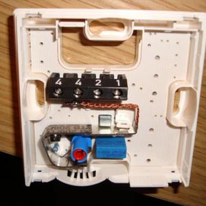

    Hi, I am trying to replace an existing potterton thermostat with a newer looking version. However as I am a complete novice I am not sue which wires to connect and in what order. I have attached a link to some pictures of the existing wired unit, the new unit which gives options of 4,4,2 &...
