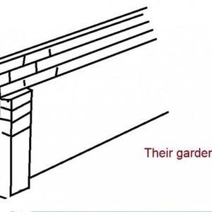

I I use the word simply as it seems to be the way they have done it is the most simple way possible.... and no not a concrete foundation.
I have attached a quick sketch - http://www.diynot.com/network/lizzyuk/albums/

The foundations of the single thickness wall is one breeze block deep. The wall is supported at one side with a wall half the height coming off it at a right handle.
The wall was built by next door and...

I have a house which is on ground 1 meter higher than next door, although the their back garden slops up to the same level as mine. Over the last month next door have dug out their slopping garden to make it flat. Now their land is 1 letter lower all the way across than mine.
