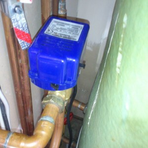

    Yes I did finally on the weekend. Couldnt have done it without the help on this forum. And the explaination above on how to be a better and not needy customer makes sense and will sure come in handy next time. Luckily the actual valve seemed ok so could do with the motor head only. I didnt...

    I got a multimeter. What should be I be looking for ? Just voltage/live coming on. I have been trying to open the 3 port valve box on top but not sure how to open the blue covering ... could you explain photo attached... the valve gets stuck on the right as it showsDSC_0032 by LKO posted 29...
