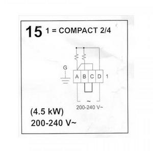

    Yes I believe there to be a switch between b and c or have b and c connected so as to run the two elements at the same time. Thanks for your your advice and direction but I need to source and electrician and get this properly sorted thanks again
  2. L
    Wiring Daigram
    Yes to reappraise thanks
  3. L
    Wiring Daigram
    Thanks for your advice duly noted
  4. L
    Wiring Daigram
    Yes that makes sense unlikely it will be ever used at full power anyway. But I am correct in think you can NOT apply diversity to this?? Now need a electrician to sort the wiring diagram!
  5. L
    Wiring Daigram
    So that would be that 20 amp MCB RCD protected 4mm cable (don't think I should go any less) . Reference of Plastic conduit clipped to ceiling what else??
  6. L
    Wiring Daigram
    So i am thinking that 4mm would be better on a 20 Amp MCB with 30ma RCD protection
  7. L
    Wiring Daigram
    The cable will be run through plastic conduit and clipped to the ceiling. It does not pass through any insulation or floor joists
  8. L
    Wiring Daigram
    Thanks for this as it 4.5 KW that works out at less than 20 amps and probably 6mm or 4mm cable as the the run is only 5 meters.
  9. L
    Wiring Daigram
    Hi Can any body help? I am helping a friend wire up a sauna but we are confused by the wiring diagram I know where earth goes but where does live and neutral go and what is the loop between B and C?. http://media.diynot.com/203000_202844_59867_87659208_thumb.jpg Thanks
