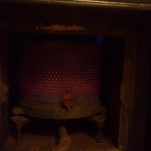

    Rayburn Royal OF7 - Fumes in hot oven since oil tank work
    OK, been checking a few things on the Rayburn and found that the oil depth in the burner is approx 8-9mm which i'm assuming is too high?? This figure is with the BM30 at its lowest (it was about 10mm to start with). Do I need to lower the mounting bracket a few mm to get the oil depth down...
    No, not the best picture! It shows the flame on number 4 of the BM unit. Will screwing down the nuts increase the pressure of the oil coming out ?? Is that what determines the oil depth or is it something else? Would you normally expect this sort of smell in the oven if the oil level is too...
  5. L
    Attached an image here of the burner in action, any thoughts?
