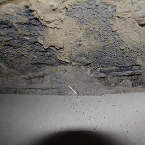

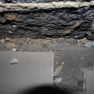

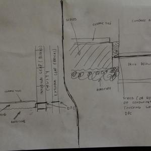

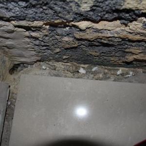

    Filling the gap between concrete floor with no dpm and wall
    Forgot to mention that the screed is approximately 4-5cm above the dpc.
  7. L
    Concrete ground floor. No DPM. Cavity wall with bitumen dpc. Screed with ceramic tiles laid on it. House built in 60's. The screed touches the wall above dpc in many places. Please take a look in the album: http://www.diynot.com/network/lookieluke/albums/23283 where I uploaded a few...
