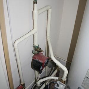

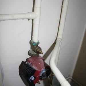

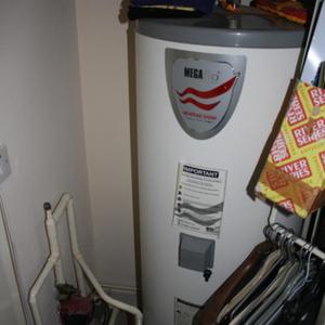

    Here's some pictures of the boiler room/pump... You'll have to excuse the mess in the cupboard :p

    Hi guys... For the past few weeks, our central heating has made a weird rattling/gurgling noise at around 5am every morning. It's really starting to annoy us now, because it's waking out child up (whose room is just opposite the water tank/pump), and he's refusing to go back to bed... So...
