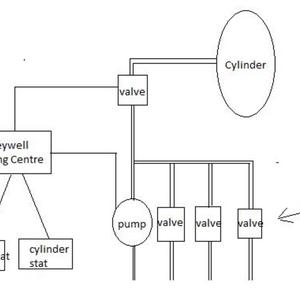

    Thanks Matt. Yes, the valve is on the output of the coil. Yep, those are the centaurstats one upstairs and one downstairs, they're all wired into the wiring centre. The 3 redundant zone valves are connected as follows: What's the purpose of the single zone valve if it's not there...

    Recently moved house and have been unable to turn off the heating. The heating system includes two centaurstats, a horstmann channelplus h27 programmer that all seem to feed into a Honeywell 42005748-001 Wiring Centre along with the pump, hot water cylinder stat and a Danfoss 2 port spring...
