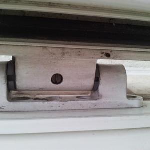

    UPVC door not closing properly near keep end
    Gazman16 : I tried to put the washers i ordered above into the hinges, was able to open the hinges , but the above washers did not fit(just figured out they are called plastic Bushes not washers) , and after opening the hinge , the existing worn out washers look a bit like mushroom shaped or "T"...
    Thanks Gazman. I have ordered below, hopefully one of them will fit in. http://www.amazon.co.uk/dp/B0075WP40W (Nylon Washer Selection - Pack 60 - Metric Washers M3 M4 M5 M6 M8 M10 Natural Nylon 6.6) will let you the outcome
    Thanks Gazman16, I will try your solution over the weekend, but do you know if i was to just put new washers instead of swapping them, do i need to buy any special brand, quality or size ?
    Hi Experts, I have a upvc glass door which shuts only if i lift the door a little using the door handle, otherwise it touches very slightly to the bottom keep end in the door frame. Once shut it's fine, but am worried if i carry on like this , it will get worse. I have seen some online...
