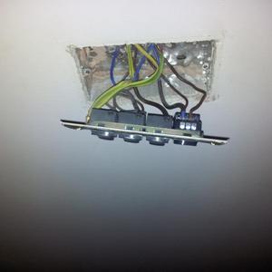

    Thanks for explaining it - understand it now. Have a new dimmer switch ordered so that should do the job. Thanks again.

    The GU10 bulbs I've purchased have an internal fuse, but this bulb was in the property when I purchased it (new build) around 3 / 4 years ago, and has never needed replacing - so perhaps a chance it didn't have an internal fuse in the bulb. The bulb itself wasn't difficult to get out and...

    Thursday night one of 4 50W GU10 bulbs blew. Very loud bang, glass fell out of the bulb(!) and tripped lighting circuit fuse at the fuse box. Swapped bulb out for a new one (again 50W GU10), switched fuse back on at the fuse box, all lights are on. Went to press the dimmer switch to turn...
