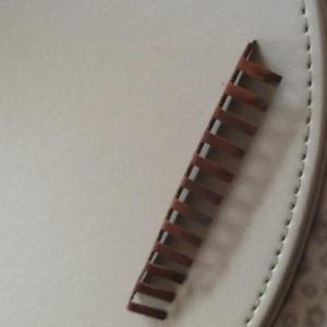

    Will do cheers SOV.. Solenoid valve. Baffle is corroded so guess it fell down onto igniter.. House was empty for 7 months...
  3. M
    Glow Worm 70ff 'software fault' code
    Hi all, noob needing help please After reading a few posts on here, i investigated the fault further by dropping off connectors for gas sov, turning off gas and all showed same fault. As I am a inquisitive electrical engineer I whipped off a the main cover, and saw that the igniter just...
