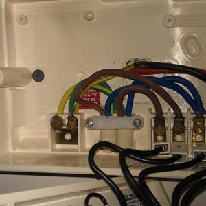

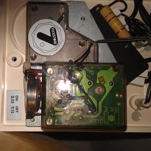

    A quick visual check inside the unit doesn't show anything odd. I've put photos in album "Horstmann". Unit has power coming in as the timer works ok (both for Boost and Econ 7) and I do get hot water on Econ 7, but not on Boost. It could be something to do with the power to the Immersion...

    It only has a 1 hour Boost option. It's one of the old style Horstmann units. I'll take a look inside and see if I can see anything obvious. I've already spent £200 getting the tank drained and element changed so want to identify exactly what's wrong if I can before getting someone in to...

    Hello, I have an immersion heater with a Horstmann Economy 7 controller. The immersion tank has 2 elements. The Economy 7 function works ok (bottom element). When I try to use the 1 hour Boost function (top element), the boost light on the Horstmann flickers on briefly but then goes out...
