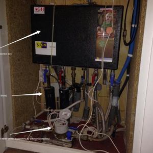

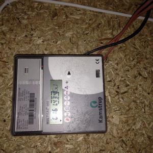

    Underfloor heating woes
    Hmm, they install a big box which is sealed with huge cable ties - so i've never seen inside it, but it's a kind of polystrene effort (see pic). There is then a meter coming out of this - it was my understanding that the billing is done as the water enters the property..... I'm not sure I...
    So, this water could be too low to heat my house any longer but too high for the supplier to want it.... right? Why would they want to restrict this? Neil

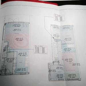

    Here is the pipe-layout:
