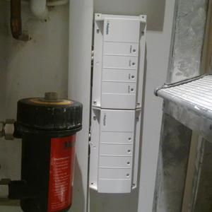

    I think there are 2 circuits coming off the manifold, but its 1 'zone', so i have 1 control unit that controls all - 1 setting for all - basically, ufh is in my newly built extension. Posting photos.

    I've switched off the UFH, will let you know what happens. Photo of UFH pipes coming

    I'm not a plumber, so trusted them to spec what i needed for the house. I'm not sure how exactly the UFH is connected. Theres a separate manifold. I'll post a photo if it will help?
