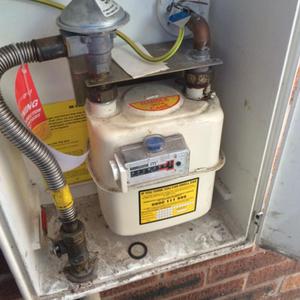

    Checking gas supply capacity
    Not in recent living memory; it's been capped for a decade. We'll find out in due course of this meter can supply 6m^3/hr. No gas safe people I've called can answer this question without there being existing equipment hooked up to it. (there is none)
  6. M
    12.5 mbar apparently. Enough that your hob doesn't blow out and cause a safety issue; not enough to guarantee you're able to run your gas appliances though. Apart from WB (TB 0040) is there anybody else that'll allow commissioning below 21 mBar? That's the type of delay I feared. Looks...
  7. M
    Are they obliged to provide 21 mbar @ 6 m^3/hr? Worst case scenario, what the usual turnaround time?
  8. M
    Pipework after the meter is not a problem. I'm talking about the supply to the meter: is the main adequate? Many aren't. How do you check?
  9. M
    Unhelpful. Most gas safe people seem happy to fit the boilers then check afterwards, with no concern for impact on timetables. For water I'd ask for a dynamic pressure check. What's the equivalent in gas lingo please? I want the check done in advance of planning all the works, not...
    Is it possible to check the gas supply capacity in advance of fitting a boiler? A site currently runs electric storage heaters from a 100A 3ph supply. (70KVA) The site has a U6 gas meter (6 m^3/hr nominally; previously only used for gas tumble dryers) and we'd like to convert to gas...
