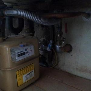

    Yet another question about moving a gas meter
    Thanks for all your help, now I just have to find someone to do it and speak to the supplier.
  2. M
    So not even with the anaconda and an aecv with the re-positioned meter outside? Like I said I don't know much about it so sorry if these are stupid questions just wanted to avoid paying so much for national grid to move service pipe. Like this:
  3. M
    Is that a bad idea? If so could a regular solid pipe be used? Just need something to get from the ecv back through the wall to the meter.
  4. M
    Thanks for the reply, but national grid charge a standard rate of £700 for moving the meter any distance. As I understand it, my supplier British Gas can consent to the meter being moved and will do so up 1m as long as the service pipe isn't altered. Question is can we take it back through the...
  5. M
    Hi, I've seen quite a few posts on this but was hoping someone could clear this up for me. My understanding of plumbing especially relating to gas is limited so apologies for my ignorance. With regards to having a meter moved from what I've managed to gather from other posts and online...
