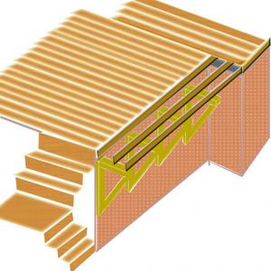

    Extending an existing decking
    Here is the diagram which I hope will help with visulisation.

  4. M
    I was thinking of using 4 brackets (horizontal par3' 6" and the perpendicular part 5' fixed to the wall and then use a timber to connect the ends by aid of steel plates). One end of the beam will rest on the wall and the other end on one of the above brackets. I can use a post to increase the...

  6. M
    Last year I built a L shaped decking, 20 feet has a width of 10ft and other 10ft is 13 feet wide. My garden's level is 7ft lower than the decking. . I want to extend the narrow part to make the whole deck 13ft wide. the garden end of the Beams are sitting(fixed) on the wall made of...
