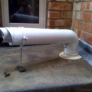

    Polish Plumbers Show How It Should Be Done!
    Vaillant Ecotec Combi Installation <br>Flue not connected to boiler with securing collar, just push-fitted<br>DIY vertical extension!<br>Condense pipe inserted into caste iron pipe after a hole was drilled.<br>Undersized gas pipe!<br>Elbow on flue not secured by collars!<br>No documentation left...
