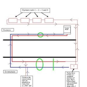

    Converting single pipe to F & R
    I get your thinking, sods law the snow will come back the day I start it. So essentially tee off the 22mm pipes for every rad yes?
  2. M
    Hello all I am a competent DIYer, I have completed many projects, including plumbing. However I have never worked on central heating. I hope you can all see the attached image of my central heating system in my new house. This picture has taken me many lifted floorboards with my head down...
