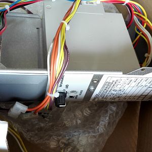

  9. Migs73
    Yet another Potterton Suprima question!
    This is a photo of the PCB I removed from my boiler, fitted into the spare assembly that came with the kit I bought. Unless someone has fitted that PCB before the boiler was installed, I've no idea how it got there. 1492074302891-873478042 by Migs73 posted 13 Apr 2017 at 10:06 AM Oh, and the...
  10. Migs73
    NB. The boiler was fitted brand new, in it was ALWAYS a new style PCB. I could only ever find people on the web saying that there was a fault in the PCB that was close to what I was experiencing. In know most of these related to the old style boards, but some people were mentioning the new...
