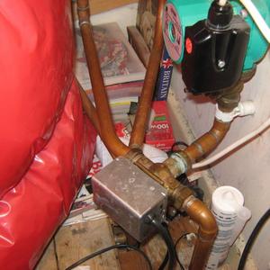

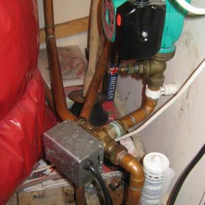

    Hi THere I have taken 2 pix and uploaded here http://www.diynot.com/network/mikeluxy/albums/6979/27707 There seems to be no valves going into the tank that I can find....

    Thanks for your help.....Im afraid im not too sure on that one...can you let me know where this valve is located on the tank....?...would it be on the top or the side...?...also does it look just like a normal stopcock..? Do you think this valve may be jammed perhaps....?

    Hi There I wonder if anyone can help on this rather irritating problem. We have an open vented system and had the Boiler replaced just over 2 years ago....we also had a complete system flush at the same time. We have a problem whereby if we have the hot water turned off (via the control...
