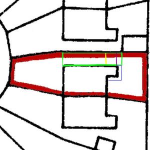

    Thanks Freddy, but doesn't the blue line mean I already have a rear extension? Which would mean that the side extension, if extended beyond the rear wall would be attached to the rear wall (black line is 1948 footprint as far as I can tell) as per first diagram on page 23 ? I think overall...

    Freddy, this is the current plan view from the land registry. Blue line is how it looks now, Green is ideal extension extents, we could live with coming back to the purple line as we'd only lose a couple of feet. If we can only go to the yellow line, could we then apply for planning...

    Hi Tony, Yes layout is as per your diagram. So we can only come back as far as the Y line? I was hoping we could come back as far as the rear of the original lean to - is this not regarded as the rear of the original house then as that's the footprint as of 1948? So if I can only come...

    It extends the original foot print by an extra 2 ft rearwards, but obviously the side wall is built over where the original side wall stood - it's just 2 ft longer at 8ft rather than 6ft. So this suggests then that I can come back past the house by 6ft to where the original addition ended.

    Hi all, Just after some advice/clarification on 'original house' where a part of the original side wall extending beyond the rear of the main house was taken down and replaced at some point after 1948. Specifically, we have 1930's house where the original 1928 overview plans (no...
