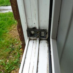

    uPVC window stuck shut on one side
    Yep that looks like it. For that price I won't even bother trying to fix it, I'll just get a replacement. Thanks.
  2. M
    No problem. After removing the handle and bottom trim and popping the mechanism out: The mechanism with the attached left bar - right side not attached! Close up of the mechanism: Close up of how the left bar is attached: Close up of how the right bar is not...
  3. M
    I have a uPVC double glazed window, hinged at the top, which is locked shut on the bottom right corner. The left side seems able to open. I put the handle in the unlocked position and took it off, then I was able to pry the window to the left enough to free up the stuck side allowing me to...
