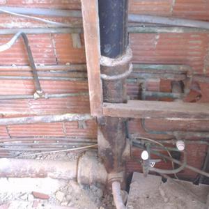

    Thanks guys seems like i have a couple of options there to solve the problem Now all i have to do is make sure the people in the flats above don't have a dump whilst i'm working on it!!!! Many thanks again. Jon

    [/url] It is a joint collar i think - yes but it is below the floor.How do i get the pipe out? leaving the collar intact? i can't cut it flush as there is no room to get a saw in there Thanks again

    Thanks - wasn't sure if the ribbed end would go above the flange.I'll measure it tomorrow.when you say 4'' is that the external measurement? ive added another picture showing the waste pipe coming in.i hope the bend from this ends with enough room left to cut the soil pipe?

    Hi Folks Experienced help and advice please. I have a cast soil pipe in small riser about 50mm from the wall.I would like to replace the connections section with plastic but would like to know if i can cut just above the flange which is only just above floor level because i can't cut any...
