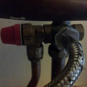

    unvented cylinder discharging
    I have an unvented cylinder, it is a range tribune he. I called a plumber to look, so far he has changed the temperature relief valve which is on the side of the cylinder and also tookthe expansion vessel down and checked. He said there was no pressure in the expansion and has reset it to 3bar...
